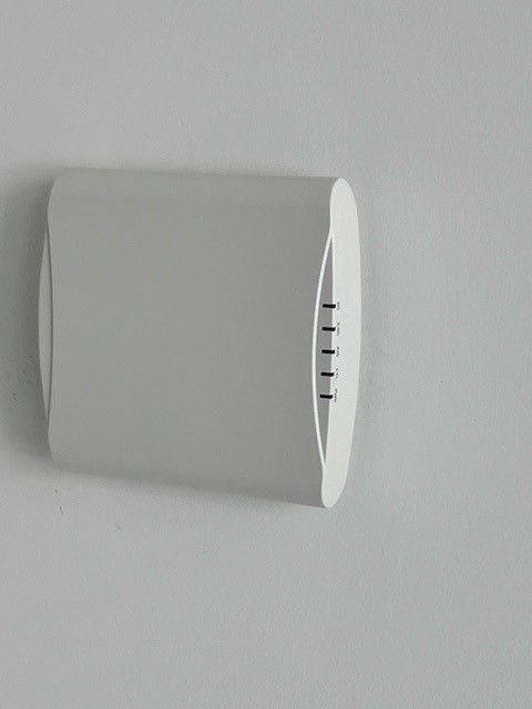

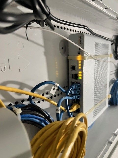

Amber/Orange light on "SYST" & Green light on "PWR" & NO lights on APs after a power outage
mrq201
I decided to post a new one.  I am getting this same error, and I have seen many others have had this same issue.  Has Ruckus support finally resolved this?  I tried the reset with a pin and now, all I have is a green power light with all of the other lights blinking.  Please please please.  How do I get this resolved?
I have the ruckus 7150-C12P.

Hi @mrq201
Based on the information provided, it appears that you are experiencing issues with the RUCKUS ICX-7150-C12P Switch displaying an orange SYST LED.
We sincerely apologize for any inconvenience this may have caused and are committed to assisting you promptly.
As an initial step, please attempt a hard reset using a paper clip by pressing the reset button multiple times (30–40 presses). If the issue persists, the next recommended step is to perform a software recovery on the switch.
You can refer to the following RUCKUS Lennar Knowledge Base self-help article for detailed instructions on the recovery process:
https://community.ruckuswireless.com/t5/RUCKUS-Lennar-Support-Knowledge/Fixing-RUCKUS-Switch-with-an...
Please let us know the outcome once you've followed the steps.
