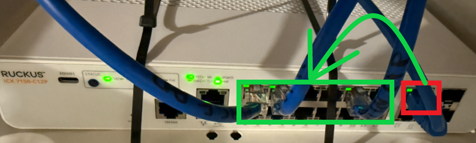

Hi @ECI
Based on the picture you shared, it appears that one of the Device’s Ethernet cables is connected to the incorrect port on the RUCKUS ICX-7150-C12P Switch. The cable should be connected to one of the 1-12 ports on the switch (please refer to the screenshots below). Kindly unplug the cable and reconnect it to the appropriate port. Once done, check your internet connection after some time.
Please let me know about the outcome.

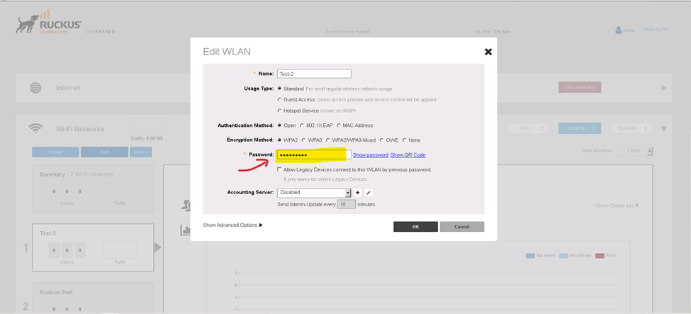

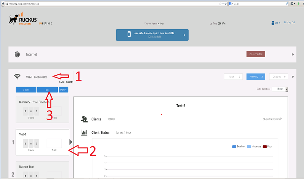

Hi @ECI
To assist you further, could you please provide us with the following details:
- Log in to your Unleashed system using a laptop web browser with the Master AP IP Address or visit https://unleashed.ruckuswireless.com/
Select Wi-Fi Network>>Select your WLAN Network (SSID)>>Edit WLAN (Check the details)
(Please refer to the screenshots below)
Additionally, you can try to create a new Wi-Fi network from the Unleashed system and try to connect your Laptop to that one.
Below is a RUCKUS Lennar Knowledge Base self-help article on how to create a new Wi-Fi network using Unleashed.
https://community.ruckuswireless.com/t5/RUCKUS-Lennar-Support-Knowledge/Guidelines-on-creating-a-Wir...
Please let me know how it goes.
