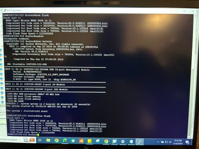

This issue may happen when the Switch runs on the Routing code (SPR). The Switch should run on the Switching code (SPS) to avoid these issues for Lennar home users. If the Switch boots up on the other partition (Due to a power outage/power spike) which may be running on a ‘Routing Code’ results in causing this issue. To check the same please follow the below process.
ICX7150-C12 Router> OR
ICX7150-C12 Switch>
show version
show flash

I have no idea what our login details are. We were never provided a username or password. How do I get that info or reset the switch?
05-16-2023 03:44 PM
I have managed to figure out the default login details. What do I do from this screen? I managed to log into the unleashes up and the AP updated.
05-16-2023 06:18 PM
We have a very weak and slow signal, I believe we have run the commands properly. Please advise.
