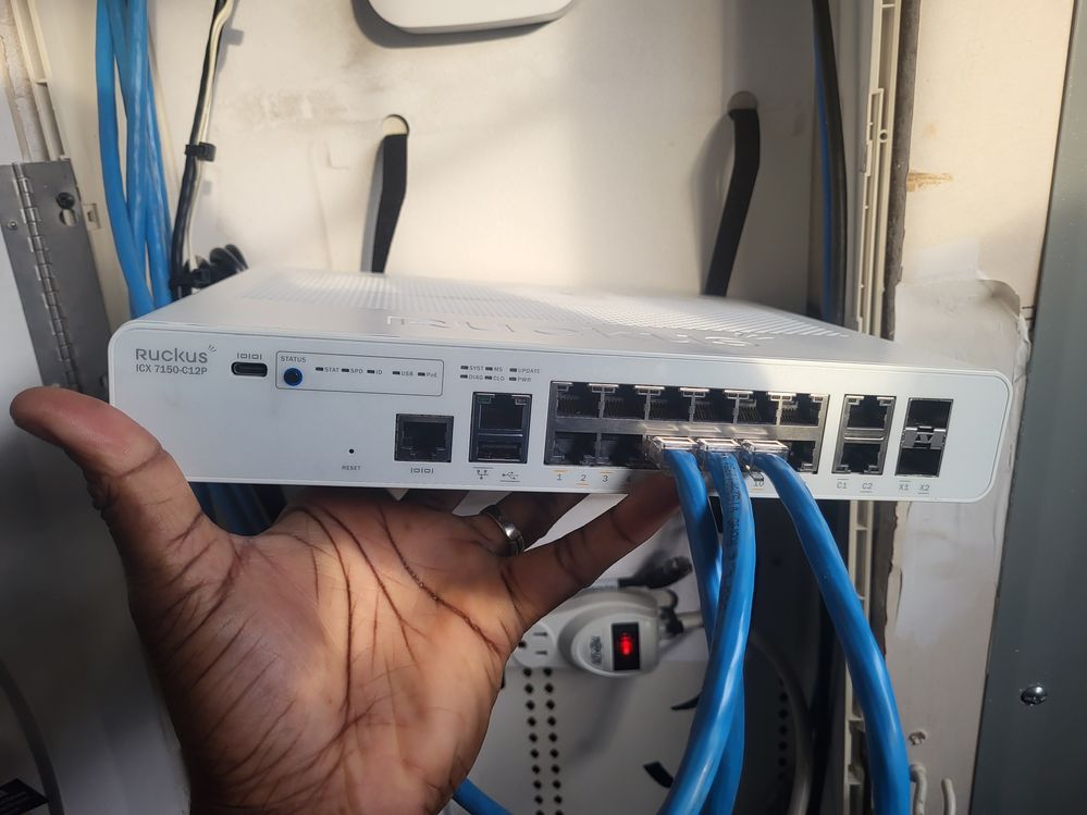

The Ruckus 7150 is not powering on, This happened late this afternoon with no warning. It affects the 4 switches in my home. Request assistance and replacement. Ruckus Networks Support Case 01475774

Could you please help us with the picture of front panel of the switch for all four switches ?

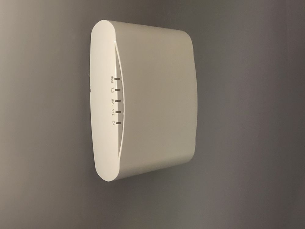

May I know how many Access Points are connected to the Switch? Could you please let me know the light status on the Access Points? Any of these lights are on (Please refer to the below picture and share a picture of the same)

Please help us with pictures of your ICX-7150-C12P Switch showing the status of the lights. Also, light the status of Access Points.

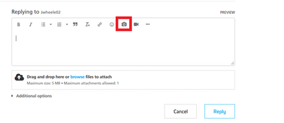

Please upload the pictures using the below option in the portal.

I know about how to console into Ruckus 7150, it is not powering on at all. the 4 aces saints the 7150 is connected to is not showing connectivity lights also because Ruckus 7150 is not powering on. There was no power outage at all when this happened. It needs to be replaced.
When i try to upload image it states :
You do not have permission to upload images.
