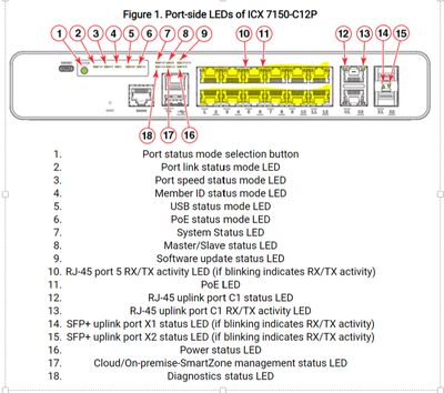

I have a ICX 7150-C12P ruckus with connection to two WAP. One WAP has all green lights except for Air (I assume is working fine), the other has the power showing green, 2 Amber lights for 2.4 G and 5G and no lights for AIr and CTL. For this WAP, I’ve tried unplugging the WAP and replugging in. I’ve also tried using different ports on the Ruckus box and get same result. How can I fix this?

Based on the description, the second WAP is fine and well-configured. The light on AIR should be off. The CTL is only lit up on the WAP that has the roll as master (this is the way you can distinguish the master and the slave). The Radios 2.4 and 5g are Amber when the WAP is configured but no clients are connected to that specific radio or WAP.
