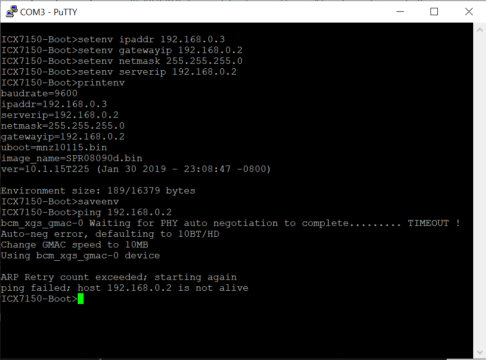

04-20-2023 04:49 PM
Hi Imran,
I have installed putty, tftp and drivers. I have tried all the configuration which you mentioned in link, but from putty I can get an error 192.168.0.2 is not alive. Please find attached screenshots.
04-20-2023 05:14 PM

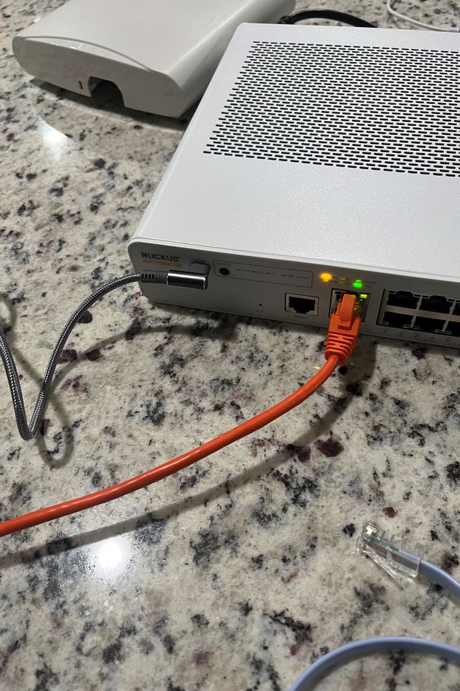

Hi @viplavse
As I see from the screenshot, you have only used an ethernet cable to USB for the software recovery process and it is plugged into the incorrect port on the Switch panel. It should be plugged into the correct port as marked in the screenshot below. Please use ethernet cable (both ends RJ45 plugs) and USB to type C cable both together as described in steps 2 & 3 in the guide link. Request you follow the same and perform the software recovery process once again.

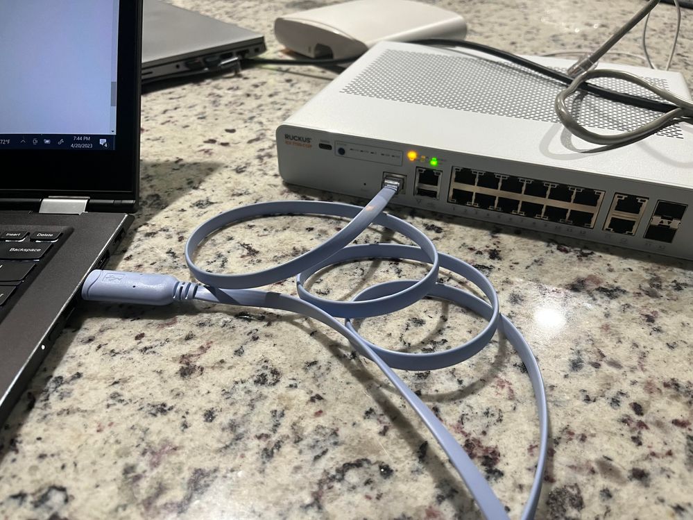

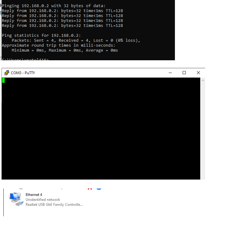

04-20-2023 06:56 PM
Hi Imran,
Thanks for quick response. I have tried to swap the plug and also connect RJ45 in both end switch and laptop. Now good thing I am able to get Ethernet connection and also able to ping 192.168.0.2 also Putty is starting the session but boot> is not coming. Please find attached screenshots.
04-21-2023 08:35 AM
Hi @viplavse
Greetings of the day!!!
Could you please reboot your Switch once and perform the software recovery once again on Putty?
If still you are getting the same result, I request you please download the MobaXterm app similar to Putty and perform the same operation once again there.

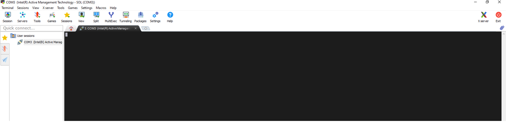

04-21-2023 12:26 PM
hi @Imran_ruckus,
Happy Friday..
I have tried to reset switch and also try to use MobaX but here also same result no boot> is coming.
