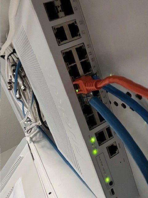

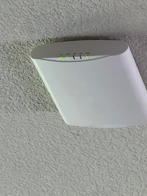

I have ruckus 7510-C12p with 2 R510 APs on each floor. Replaced router to Netgear AX1800. Internet drops frequently.
16 REPLIES 16
AP2 upstairsAP2 upstairsAP1 downstairsAP1 downstairsSwitch: Two blue are for APs and orange is from router.Switch: Two blue are for APs and orange is from router.

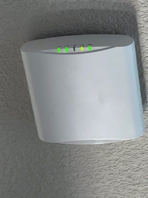

I have been able to factory reset APs. The switch (IP address: 192.168.1.87) is disconnected. Attached is the picture from one of the APs (IP: 192.168.1.78/38). How to fix the switch issue?
