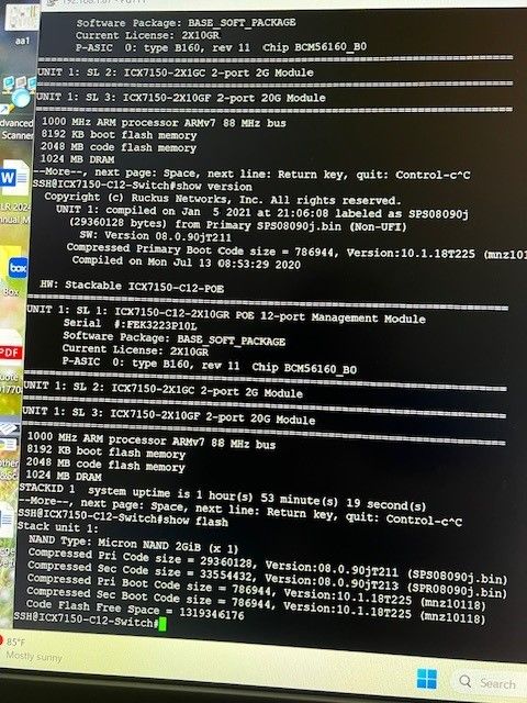

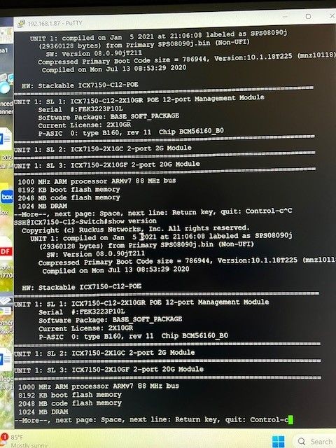

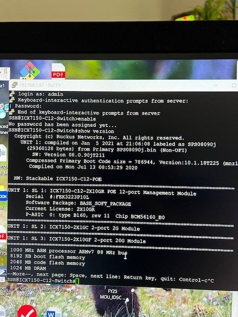

  1. To check this, we must identify the ‘current’ IP address assigned by your local router to the switch ICX-7150-C12P
ICX7150-C12 Router> OR
ICX7150-C12 Switch>
show version
show flash
command: enablecommand: enablecommand: versioncommand: versioncommand: flashcommand: flash
