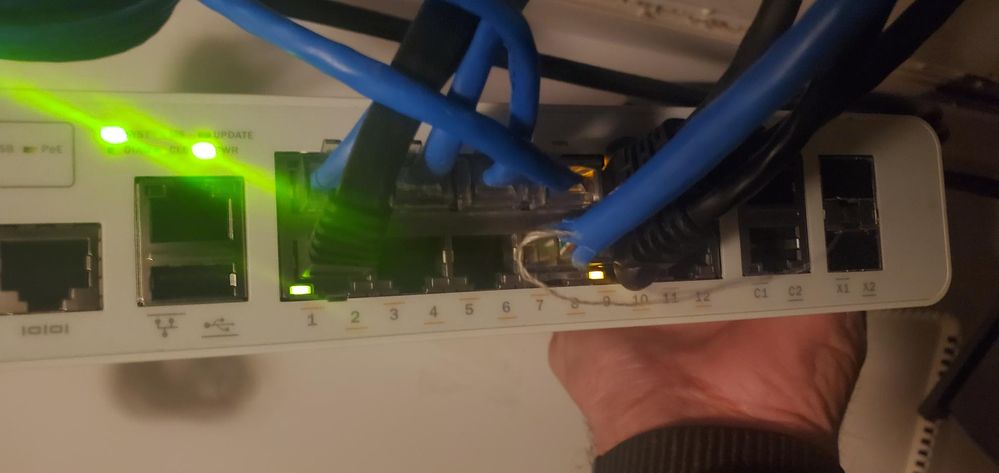

My access point won't turn on after a power outage both system lights are showing green not Amber so don't do the reset not sure what to do here

As per the picture you shared previously, the light status of the RUCKUS ICX-7150-C12P Switch is in a normal state.
We may need to check some configuration and Switch ports information. Please follow the below process and help us with the same.
