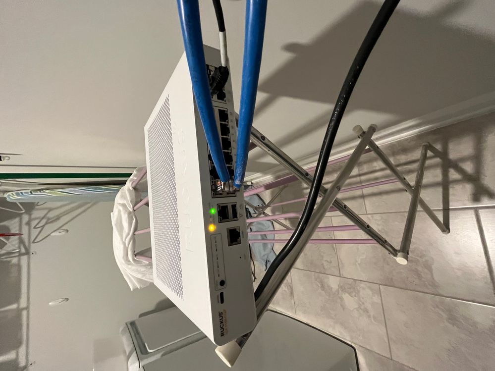

1. On your switch while it's plugged into the outlet, do you see any lights on? (Amber or green) Please let us know which lights are on. (Please refer to the below picture and share a picture of the same, showing the light status and the FULL Switch panel cable connections to the Switch ports)

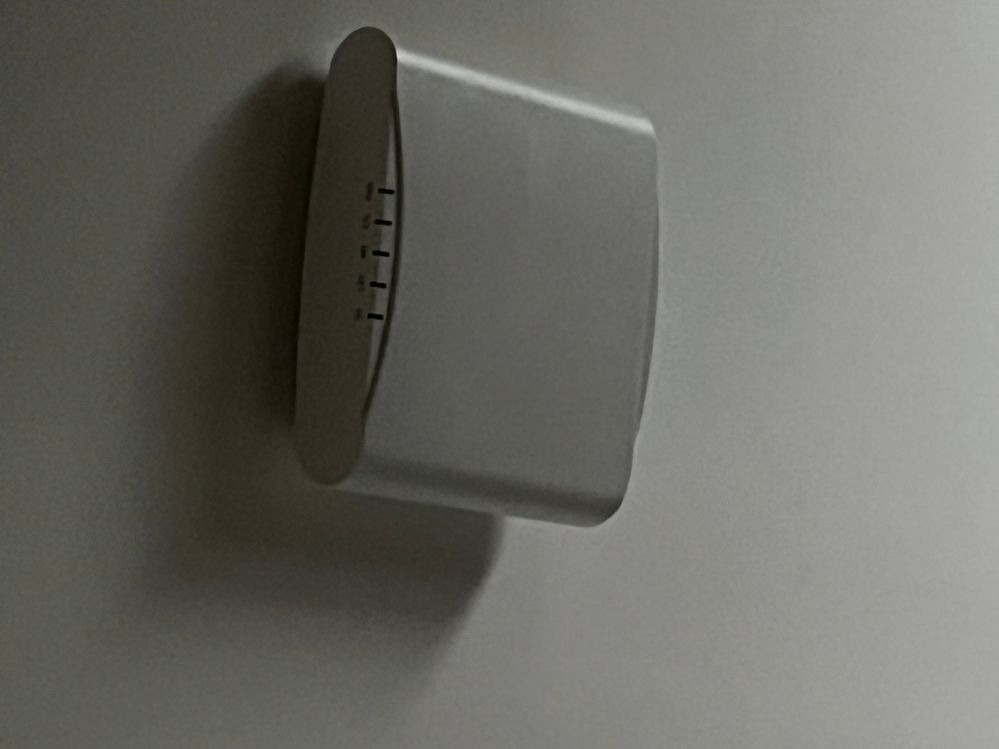

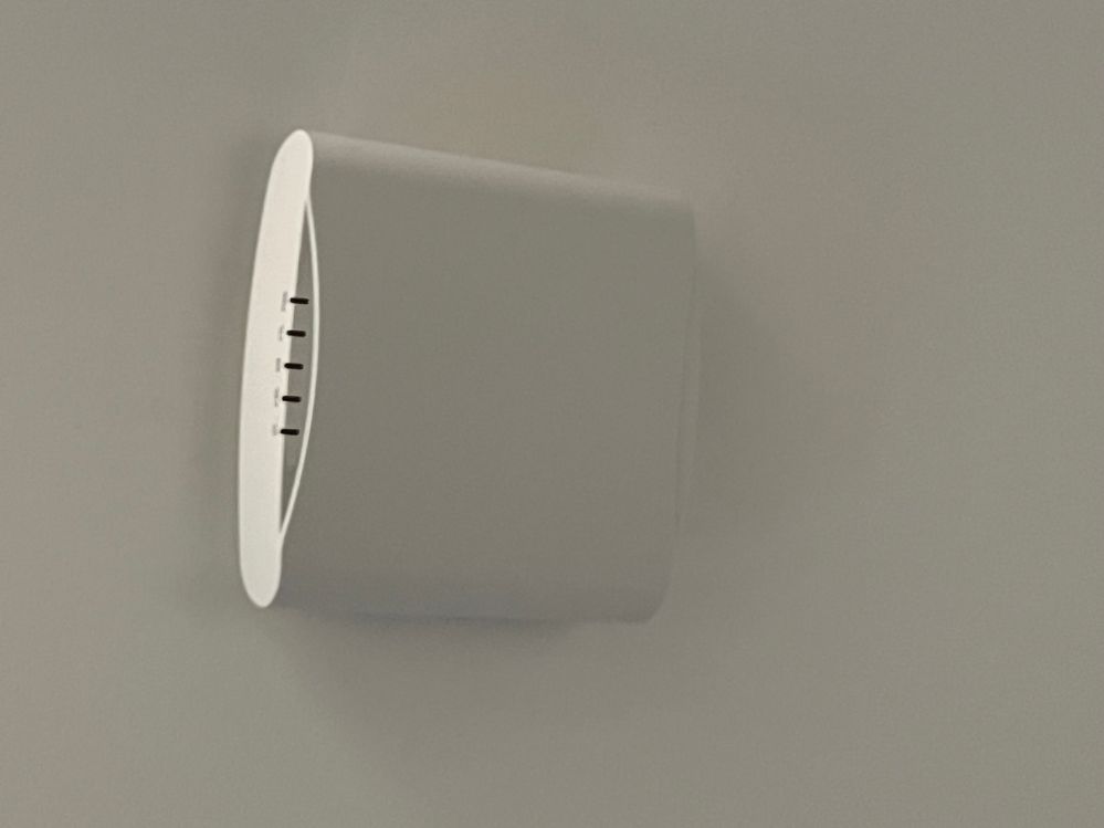

2. May I know how many Access Points are connected to the Switch? Could you please let me know the light status on the Access Points? Any of these lights are on (Please refer to the below picture and share a picture of the same)
Upstairs unitUpstairs unitIMG_1105.jpegMain floorMain floor
Hi @Mike1347
As I can see from the picture you shared, there are lights on PWR and SYST, if there is an amber/orange light on the "SYST" and a green light on the "PWR" on the Switch (as it is in the below picture). Meaning the Switch is stuck in the boot mode.
Basically, due to the power outage/ power spike, the switch went to a state that we call ‘boot mode’ that is not able to boot up properly. And this is the reason your RUCKUS ICX-7150-C12P Switch is unable to transmit power (PoE- Power over Ethernet) to the Access Points or on its ports.
First, we will try to reset the Switch as described below: Please refer the VIDEO.
  • Remove power from the switch.
  • Press and hold the Reset button while applying power to the switch.
  • After all the system LEDs flash amber, release the Reset button.
IF THE RESET IS NOT WORKING, PLEASE TRY TO RESET YOUR SWITCH MULTIPLE TIMES (Like 10-15 times) AS DESCRIBED ABOVE. As we have seen it working sometimes after trying multiple times in many cases.
