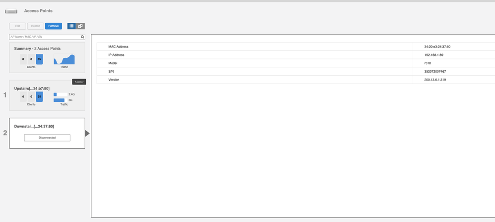

Could you please try to log in to Unleashed on a web browser and share a screenshot with the information shown below?
Hi Imran,
here is the screenshot of the dashboard, it is showing as disconnected alway even i connect just one AP.

Hi @krkogant
Could you please let me know if you tried a hard reboot of your ICX Switch (disconnect and connect the switch from the power outlet)?
If yes and it’s not working, please follow the below process.
As your non-working Access Point is under disconnected status on Unleashed even after unplugging it from the Switch panel.
Please follow the below steps.
1. Keep the Non-working Access Point (AP with a Red light) Unplugged from the Switch.
2. Select the Disconnected AP on the Unleashed and Remove it (please refer to the below screenshot).
3. Once you remove it from the Unleashed dashboard, connect the Unplugged Access Point back to the Switch port panel and check the light status and Unleashed dashboard.
Please confirm if it works and let me know if you have any queries in this regard.
