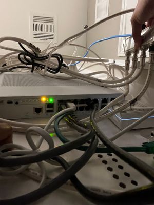

1.   On your switch while it's plugged into the outlet, do you see any lights on? (Amber or green) Please let us know which lights are on. (Please refer to the below picture and share a picture of the same, showing the light status and the FULL Switch panel cable connections to the Switch ports)

Internet connection is stable from the provider. Access points have no power and I have 2 AP’s in my home. Here is a pic of the switch panel with all of the cable connections. I have attempted a reset on the switch panel but all it does is blink with orange/amber lights for over an hour, so I ended up just disconnecting the power cord and replugging the switch panel again.
Hello @Bsaundalaya1717 ,
From the response you shared, I understand that the status lights on the Switch is Amber and the PWR light is Green, which means that the Switch is stuck in a boot mode
Please follow the below RUCKUS Lennar Knowledge base self-help article which will help you to fix the issue when the Switch is in boot mode.
https://community.ruckuswireless.com/t5/RUCKUS-Lennar-Support-Knowledge/Fixing-RUCKUS-Switch-with-an...
Please follow the process as explained in the article and let me know if you have any queries in this regard.
Thank you Pinky for your help. I did the reset 7 times and the switch panel finally went to both power and System lights to green. Problem solved....
