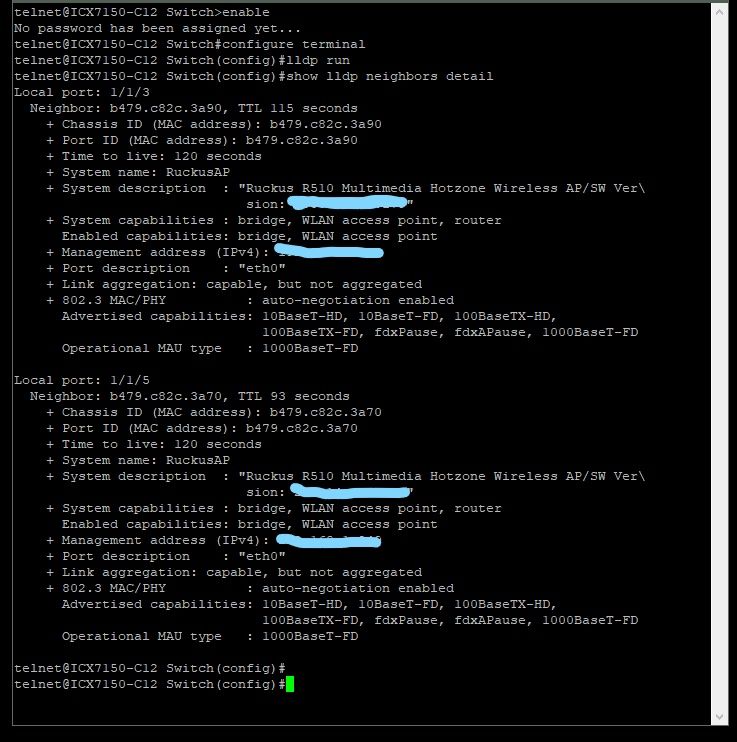

I believe you have 2 R510 Access Points on ports 1/1/3 and 1/1/5 (As marked in the below screenshot) on your Switch as per the ‘show lldp neighbors detail’ command output.
The connections are correct, now we may need to factory reset the APs. Please follow the below process to factory reset your APs to configure them with a new SSID.

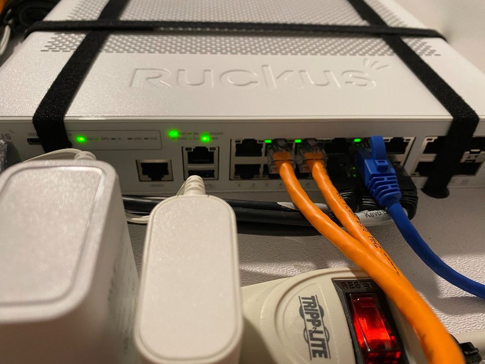

In your case remove one of the 2 orange cables as shown in the above screenshot and perform a factory reset on your Access Point once the factory reset is done, please plug it back.

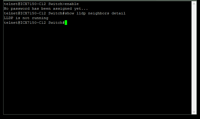

Hi @Mjxyoit
Thank you for the update.
Please try the below commands:
configure terminal
lldp run
That worked for me, thank you. I don't show a 1/1/8 or a 1/1/10lldp.jpg

May I know if you have 2 Access Points connected to your Switch?
Could you please share a full picture of your Switch panel showing port connections? (Please refer to the below screenshot)
