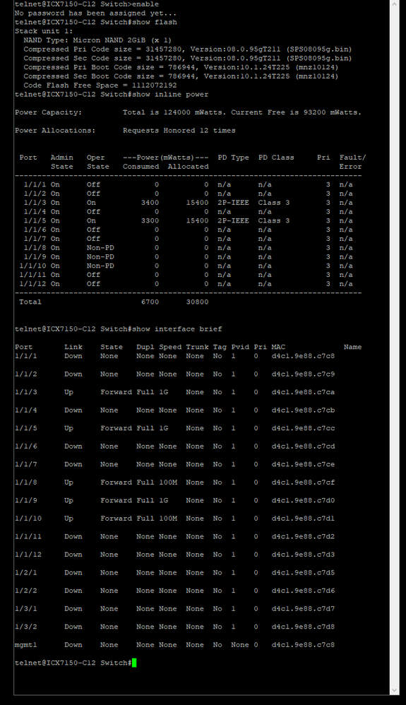

Hi @Mjxyoit
Could you please share the output of the below commands
show flash
show inline power
show interface brief
05-03-2023 10:11 AM
of course, here you go.
05-03-2023 10:25 AM
Hi @Mjxyoit
Great!!! now your Switch is upgraded to 08095g on both the partitions (primary and secondary). (Please refer to the below screenshot)
May I know which devices are connected to ports 1/1/8 and 1/1/10 since these ports are only able to transmit 100Mbps of speed? (Please refer to the below screenshot)
Please check and confirm the devices connected to these 2 ports.

05-03-2023 11:18 AM
Hi @Mjxyoit
Please enter the below commands to check what is connected to those 2 ports. (Please refer to the below screenshot)
show lldp neighbors detail
Please check and share a screenshot of the same.
