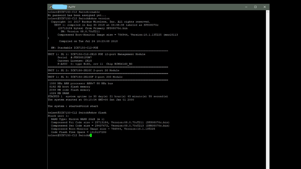

I tried beforehand, but the upload kept failing. Here you go. EDIT: disregard this message I sent a better photoPuTTY results.jpg
Hi @Mjxyoit
As I can see from the screenshot you shared your Switch is on an old Version 08070c. We recommend you Upgrading your Switch to the latest stable.
