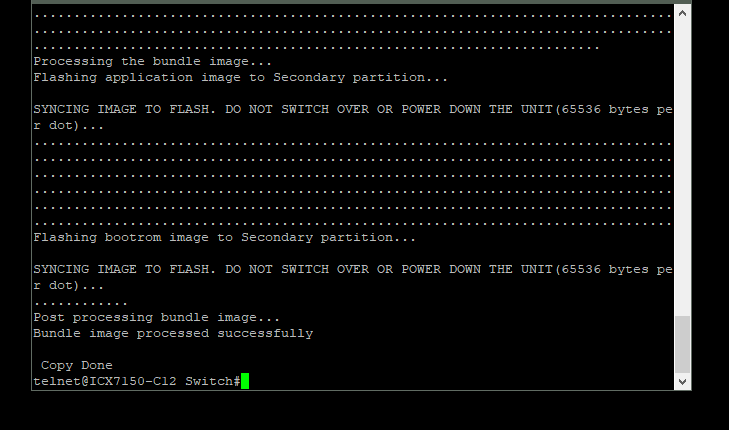

I am uncertain if this is standard procedure.
I "copy tftp flash" the "mnz10114.bin", then
"copy tftp flash" the "SPS08080f.bin", then
"Show flash", then
"Write memory", then
"boot system flash primary.
Lastly, I get prompted to select "y or n". I select y and PuTTY instantly freezes and my internet cuts out (which I think is on purpose) but PuTTy cuts out too. Making the 2nd SPS file installation awkward.
Am I supposed to select "y". There is no manual instructions in regards to that question.

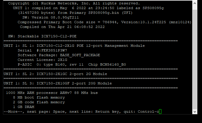

I think I did all the steps. Here are some photos to verify I completed the updates.am_i_good.PNGflash secondary.PNG
unfortunately, I still have a heartbeat loss.
