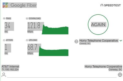

I have a two story home with APs on both floors hardwired through a Lennar home.  When speed testing to gateway I am getting 993 Mbps.  When testing from AP to device I am getting around the neighborhood of 32.33Mbps to 218Mbps.   AP to AP is testing at 195.31 Mbps.  What is a realistic expectation of what I should be pulling from AP to device?  I see there is a newer firmware version, but I am running 12.145.2 and these numbers were from when the firmware was current.

Could you please try to perform a speed test using a web browser?

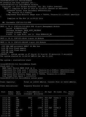

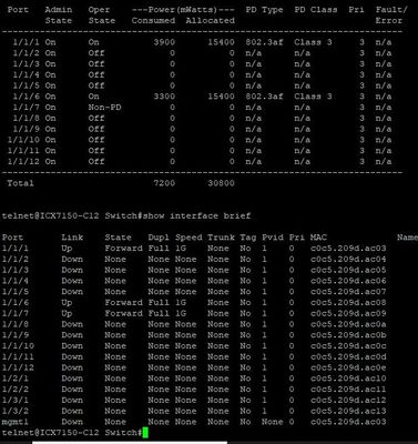

Also, please enter the below commands once you log in to CLI and share the output.
show version
show flash
show inline power
show interface brief
Should I use any internet based speed test on my web browser?  Also, I am not sure what a CLI is.  Sorry.

Please use any internet based speed test on the web browser and share the results.
Please follow to the below steps to access CLI and get the output of the below-mentioned commands.
ICX7150-C12 Router> OR
ICX7150-C12 Switch>
show version
show flash
show inline power
Sorry for the delay.  I believe I have included the info that you were requesting.  Let me know if this is not what you were needing.

The command outputs you shared in the screenshots looks normal; however, the Switch is in the non-UFI version, which is the older version.
Hence, we suggested you perform the Switch upgrade using the article shared in the previous post.
