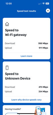

I have a two story home with APs on both floors hardwired through a Lennar home.  When speed testing to gateway I am getting 993 Mbps.  When testing from AP to device I am getting around the neighborhood of 32.33Mbps to 218Mbps.   AP to AP is testing at 195.31 Mbps.  What is a realistic expectation of what I should be pulling from AP to device?  I see there is a newer firmware version, but I am running 12.145.2 and these numbers were from when the firmware was current.

Performed the instructions on creating a new Wi-Fi network as listed above. Still only pulling 475 Mbps off my Gig fiber network.
