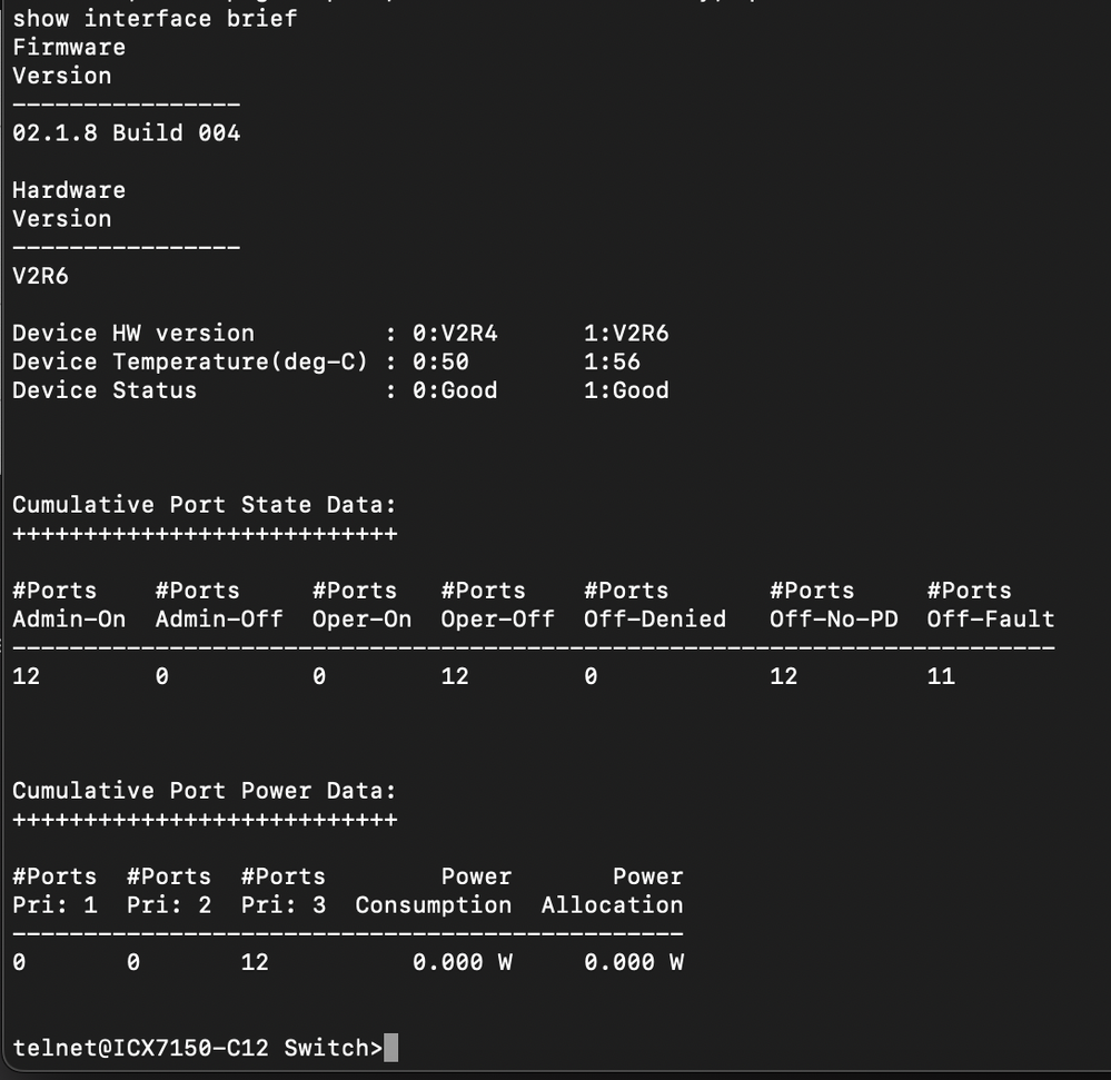

Hi @Dylannn23
Greetings of the day!!!
Based on the troubleshooting done, your ICX-7150-C12P Switch is not working, and when the Access Points are plugged they are getting power for some time and goes back offline. It's an indication of Switch PoE port issues. This Switch unit Should be RMA (Return Merchandise Authorization) in simple words replacing it.

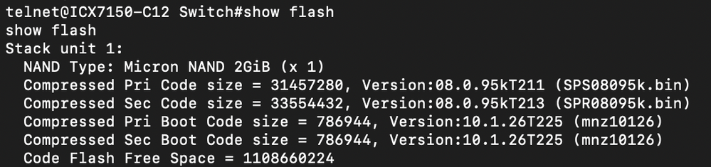

09-13-2024 06:13 PM
- enable
- show version
- show flash
- show inline power
- show inline power detail
- show interface brief
