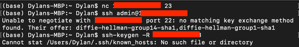

Hi. I received a replacement switch which was working fine for a few days. Now after a few days my AP has no lights showing and the internet connection is no longer showing. Below is the status of the switch and the status of the AP

Hi @Dylannn23
Could you please try to browse IP address of the Switch in a web browser and login?
Please check the other IP Addresses from the IP scan results, by the name of Ruckus Wireless or Brocade Communications to confirm the IP address of the Switch and try to login.
Thank you again for your patience and understanding
Hello. I am able to open the browser, but it will not let my sign in. I enter my username and password, but the login menu instantly pops up right away. I am using the same log in information as when I initially set up the Switch.
I checked the scan and there are no other devices by the name of "ruckus" or "brocade." Only the one I found which says icx7150
