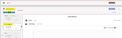

1:Checking Access Points light:
R510 LED lights
2:Confirm what radio the clients are using
expand the Clients section on the Dashboard>move the bar to the left >Radio Band
5G=802.11ac
2.4=802.11B/G/N

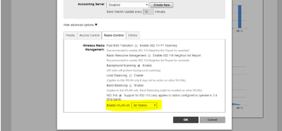

3:Check the radio set up for the SSID/Wi-Fi ID
wireless network>choose the SSID> Edit > Advanced Options > Radio Control tab
Guide:
