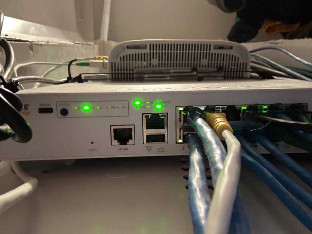

2)On your switch while it's plugged into the outlet, do you see any lights on? (Amber or green) Please let us know which lights are on. (Please refer to the below picture and share a picture of the same, showing the light status and the FULL Switch panel cable connections to the Switch ports)

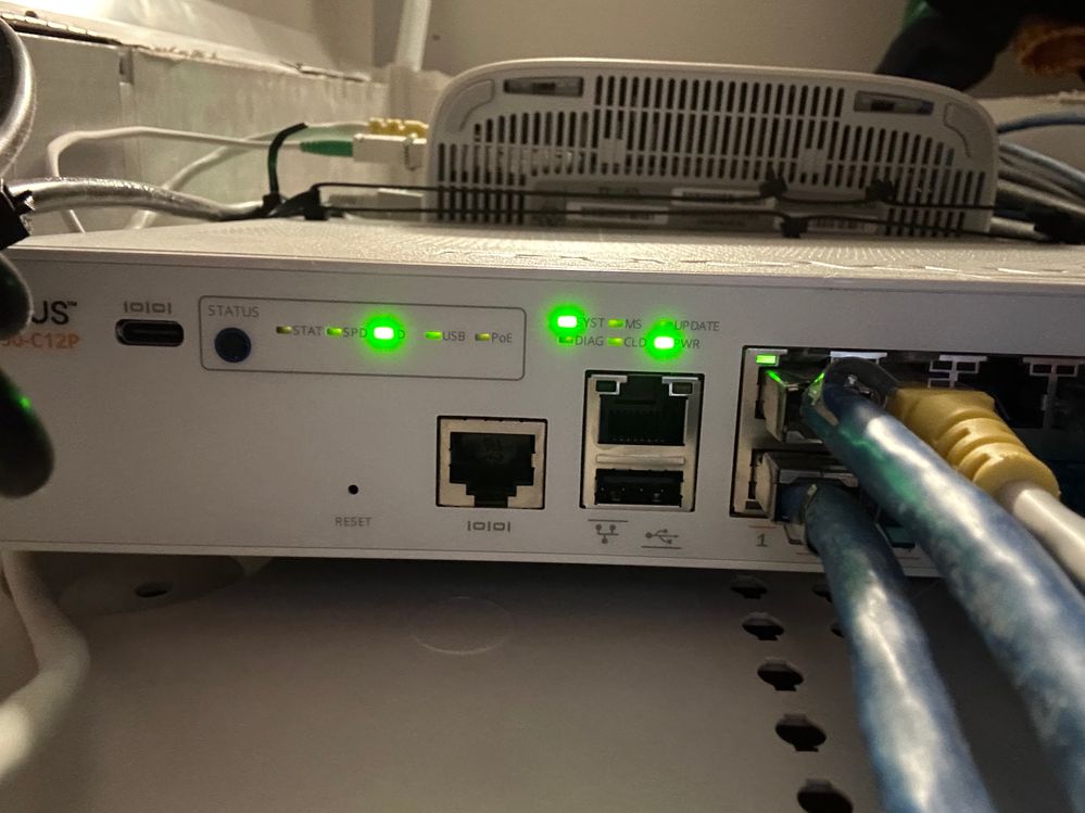

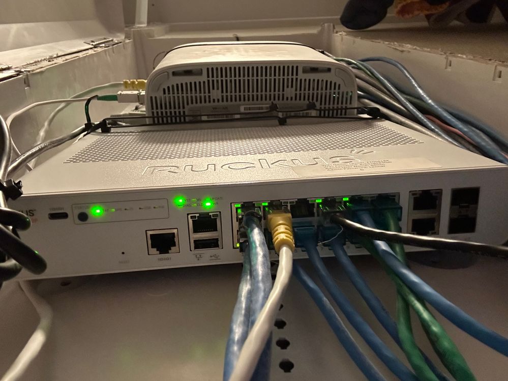

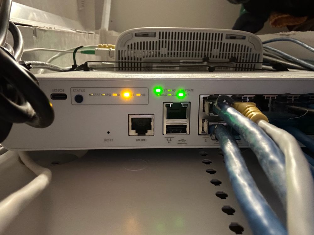

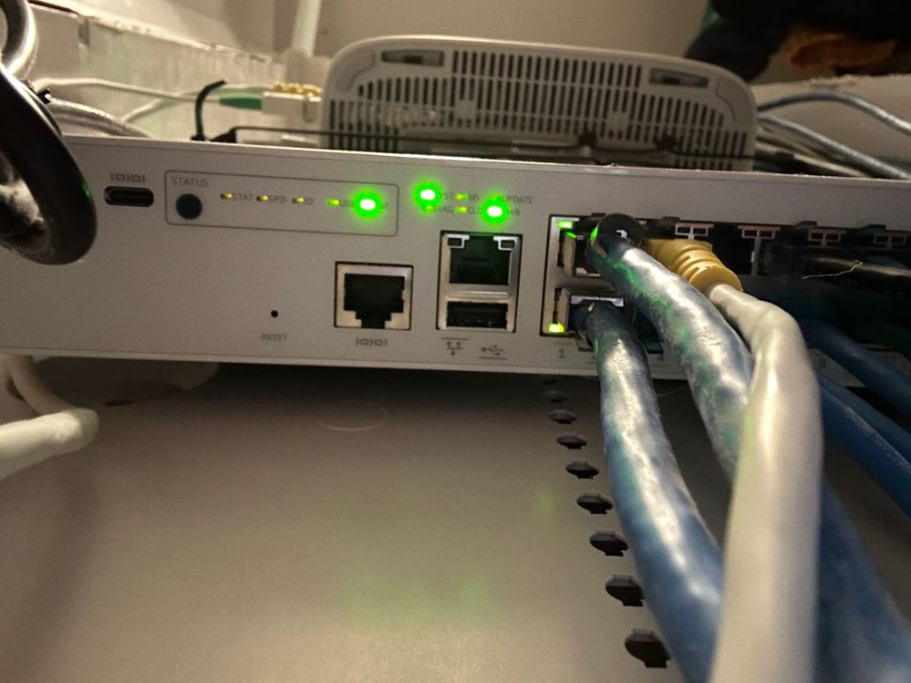

2. All lights are on the switch. Attached is 5 images of the 4 different status lights. The USB status is the only one that is orange. All others are green and the lights are green next to the connect ethernet cables.

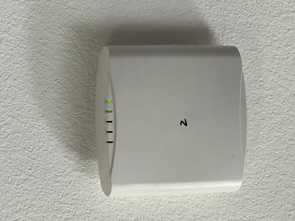

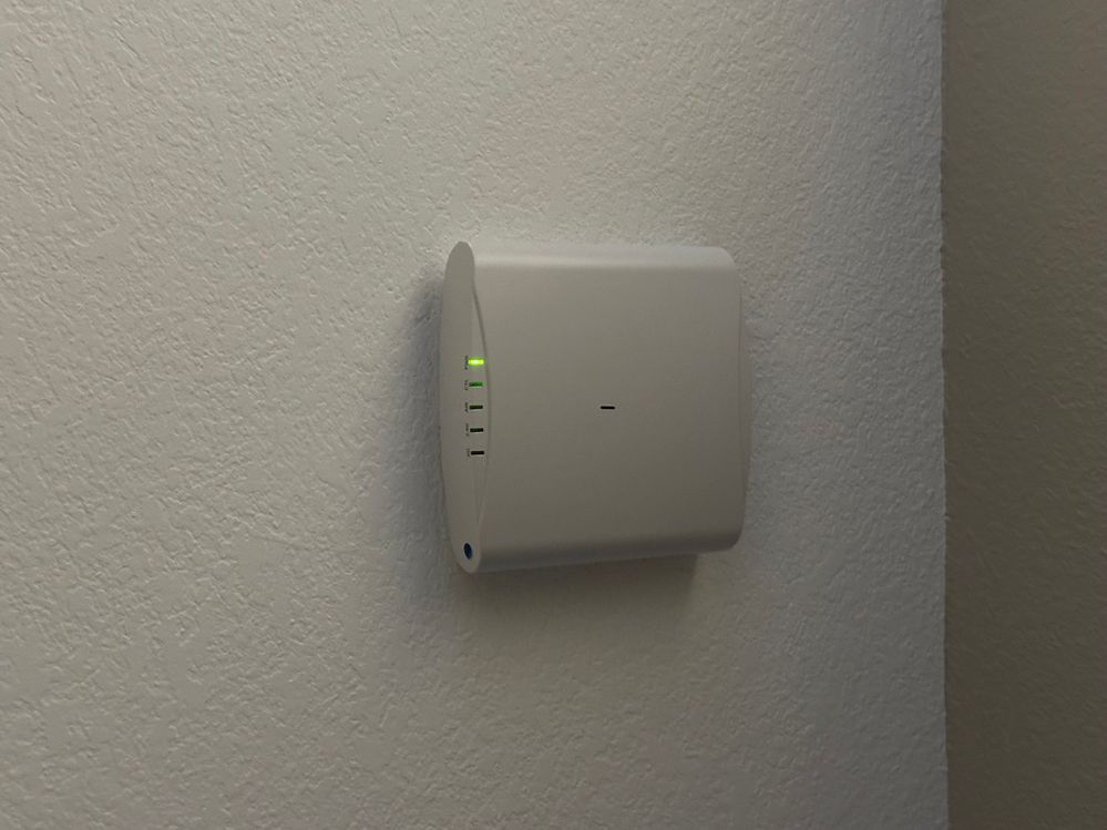

3. 2 Access points are connected. Only the PWR light is green. (last 2 pictures)

Hello @bb12 ,
As per the light status of the RUCKUS ICX-7150-C12P Switch, they seem to be in a normal status.
