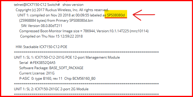

Hi @bb12
From the details you shared, I see that your RUCKUS ICX-7150-C12P switch is currently running an older non-UFI 08.0.80d version (please refer to the screenshot below). We recommend upgrading the switch, as this may help resolve the issue.
Please refer to the RUCKUS Lennar Knowledge Base self-help article below for detailed instructions on the switch upgrade process:
Kindly let me know if you need any assistance at any stage during the upgrade.
