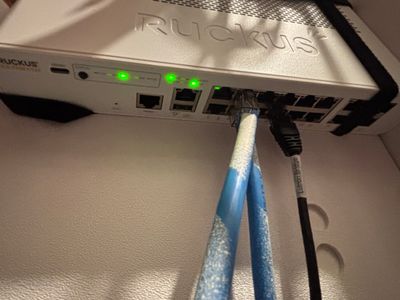

Please provide a photo showing the status of the lights and the full switch panel with cable connections to the switch ports.

Hello,
My apologies for a delayed response. Here is the picture of the switch panel. The black LAN cable is connected to my ISP router.
Thank you for your assistance.

Hi @sonia3187
Thank you for your prompt response and the information provided.
Based on the status of the lights and the cable connections to the RUCKUS ICX-7150-C12P Switch, everything appears to be in normal working order.
