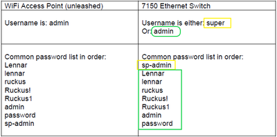

So after resetting the Ruckus switch in the media outlet, connected to my Xifnity wifi modem-router, although, i see green lights on my AP ( on the PWR Led indictor and 2.4G Led indicator, but no light on the AIR Led indicator nor the CTL Led indicator) , but I am still unable to login my Ruckus switch's online dashboard nor the Ruckus AP's dashboard -- which i assume is through their respective IP's right -- that i found from my Xfinity app.
- below are some of the common username and password for Lennar related Ruckus devices:
- in my experience, super is the username for the 7150 switch and admin for the AP
- i wouldnt be too concerned with the LED's right now, might make more "noise" once you get devices that support the 2.4 Ghz or 5Ghz bands.

Hello protocol88,
Thanks so much for providing those details, so for the Ruckus switch, none of the provided passwords work in combination with `super` as the username nor `admin` as the username.
However, for the AP, i am able to login with `admin` username along with one of the passwords provided in that list, but i am unable to find a way to add my wifi network to it.
