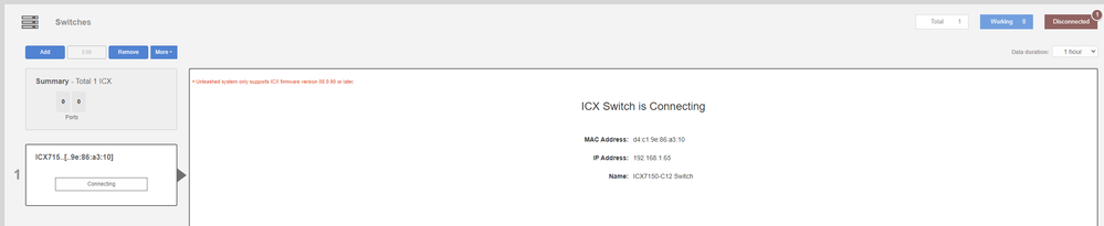

ICX Switch is Connecting
flo253
Why is this like this and why would I want to enable (or fix) this?

Hello @flo253
It seems ssh is not enabled on the switch. Please try enabling ssh on the switch using cli.

Hi flo253,
You would need to console (or telnet) into the switch and run these commands on the CLI.

I have installed the new switch. Will it always say switch is connecting and disconnected on the right hand side?Screenshot 2023-08-29 182710.png
