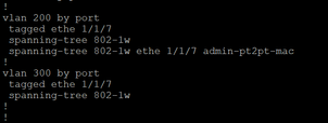

Enabling admin-pt2pt-mac in vlan:
ICX7150-48PF Router(config-vlan-2)#spanning-tree 802-1w e 1/1/1 admin-pt2pt-mac
admin-edge-port Declare the port to be an operational edge
admin-pt2pt-mac Declare the port to be on a Point-to-Point link

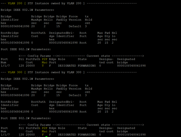

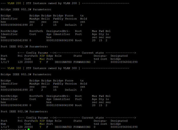

Example :
When admin-pt2pt-mac is enabled in interface level:
When admin-pt2pt-mac is enabled in vlan level:
From above two examples you can note on the difference that when enabled in vlan you can see only P2P Mac counter for vlan 200 only enabled as True applying only to that vlan. Whereas when enabled on interface level you can note that the P2P Mac counter for vlan 200 and vlan 300 is enabled as True.
Hence when enabled on interface level the port is recognized as a point to point link for all vlans where the port is mapped as tagged or untagged interface. And when enabled on vlan alone it is recognized only by that vlan as point to point interface based on above test.
Hence it is recommended to enable admin-pt2pt-mac on a interface rather than a vlan.
