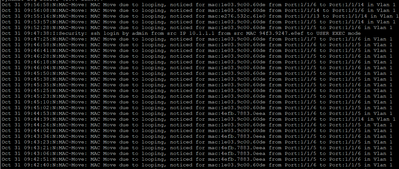

I have a network where I have an ICX 8200 and everytime a WiFi device moves from AP to AP creates a loop error. Has anybody encounter this error before?

I understand that in ICX 8200 every time a WiFi device moves from AP to AP creates a loop error.
I have a question for you here :
Are you experiencing CPU spike ,Port utilization spike ,and among others which includes Duplicate ip address
you can verified the above with the below commands :
show cpu (3 times every one minute)
show cpu task (3 times every one minute)
show interface | i line | util
show logging
de (3 times 1 minute apart)
If in the above is logs we see increase in cpu spike or duplicate ip adress then there could actually be a loop.
Common logic followed in mac-movement, is when there is movement between the 2 set of ports : the warning is triggered and this could be a false positive .
And also i would suggest you to check the connections and ensure that there is no loop in the network

Hi Caliparcerito ,
Thank you for reaching us
Adding to the post you can also try to track any one mac address from the messages you are seeing and check if it ends up on a device like PC or any end device connected to Wifi.
This will help you to check if the device which is roaming between networks are the one showing those messages.
If that is the case then the messages will not cause any impact to your network.
Commands that can help you trace the mac address on the switch:
  • Show mac-address | inc <mac address>
  • Show arp | inc <mac address>
  • Show lldp neighbors detail ports e <port number on the mac address table>
I hope these details help you
