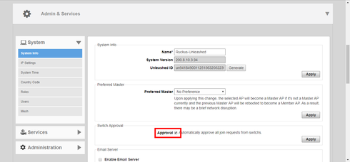

Your switch is not being assigned an IP address. Can you press continue? Also, make sure you have auto approve selected.

03-21-2020 06:51 PM
Also i do have that setting "checked" for switch approval.

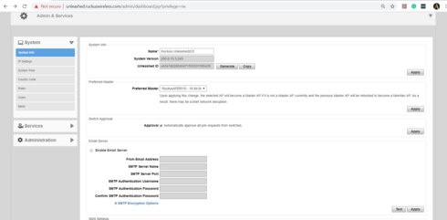

03-21-2020 06:53 PM
Here is the screenshot:

03-21-2020 06:53 PM
Try assigning it an IP address. This needs to be a free IP address that is not already in use. Only you can know that, either by logging into your router or running a LAN scan such as Net Analyzer on an iPhone. Let’s try our luck and assign it the following IP address: 192.168.0.253
