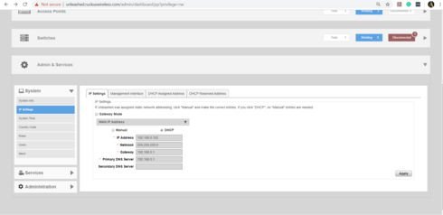

Here is the IP setting of my AP'sImage_ images_messages_5f91c485135b77e247acd3af_d9876b86df815047e2ebf66a6a837592_RackMultipart20200322900121327-b61f79bb-3e6c-4064-88ad-f86db02f4298-1850270800.PNG1584839789
It looks like the issue is with the switch, not the access points, since it shows the switch as disconnected. What are the IP settings on the switch?

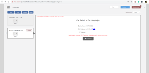

Image_ images_messages_5f91c485135b77e247acd9e2_2b0c1e781014518922d00daba68ab948_RackMultipart202003221229235q4-e2b61d85-85a9-46e3-b88a-afcaa756cf78-1913086063.PNG1584840812
This is what it says on the switch. Any advice?

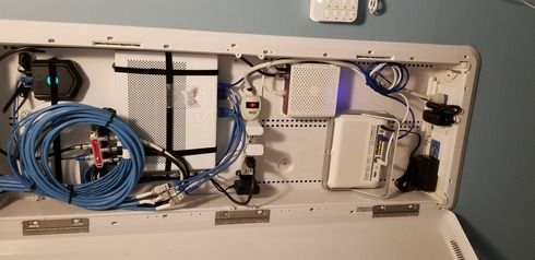

Also here is my set up. Which wires do I change out?
Thanks for your help. Its much appreciated.
