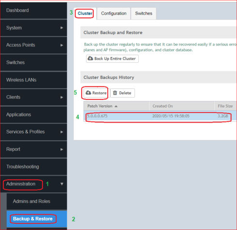

Hi Bye,
There are total thee ways to downgrade vSZ.
1st: If a cluster backup was created during last upgrade or before, then you can easily restore it and system will downgrade to previous version with all the settings.
