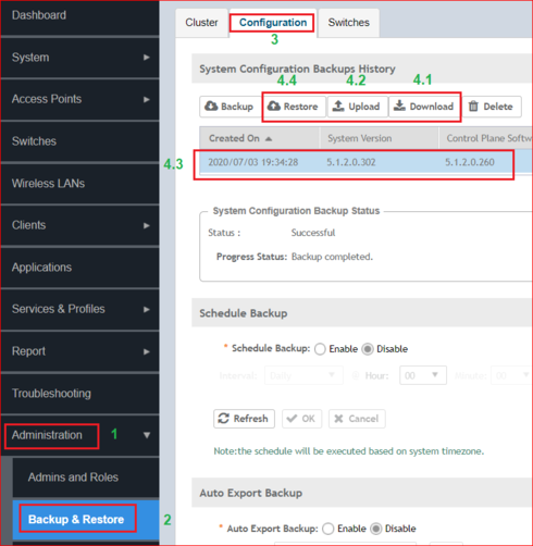

There are total thee ways to downgrade vSZ.
1st: If a cluster backup was created during last upgrade or before, then you can easily restore it and system will downgrade to previous version with all the settings.
Image_ images_messages_5f91c48b135b77e247ae0468_e1067f4b2766072c6d744e77934027e7_RackMultipart202007037940ifdde-8c2e5c82-5a2a-478e-bf20-96402551c2c1-1120033680.png1593785074
2nd: If you don’t have cluster backup but a configuration backup was taken and available, then you can downgrade the vSZ using desired firmware or by deploying a new vSZ with desired firmware. Once this is done, upload the configuration backup and restore it.
Image_ images_messages_5f91c48b135b77e247ae0468_e0c798fe5c0f1eb1d208905f72045e81_RackMultipart20200703122041rxx-dc086665-2705-4182-94c2-bfbd194a9c3e-1360112863.png1593785520
3rd: If no cluster or configuration backup available then downgrading vSZ will factory reset its configuration and you have to reconfigure it from the scratch.
IMPORTANT NOTE: All 3 ways required downtime as system will restart or reconfiguration will be required.
