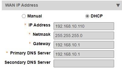

Hi Sarita,
thanks for a prompt response
Image_ images_messages_61dd7869caf3a82d69353958_d036806af4a49a96f2666c58bda058ca_DNS-8fe729ae-492d-455d-a7d5-c9962c97b0c3-1763057284.jpg
DNS set via DHCP (static lease)
