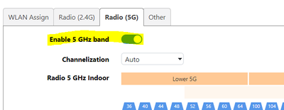

You can do the upgrade, if you face the issue with the channels, just disable the 5 Ghz from the Global prompt and re-enable it. This will make the channels available again and the issue will be solved.
