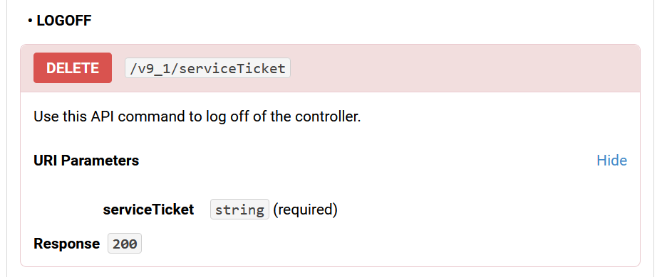

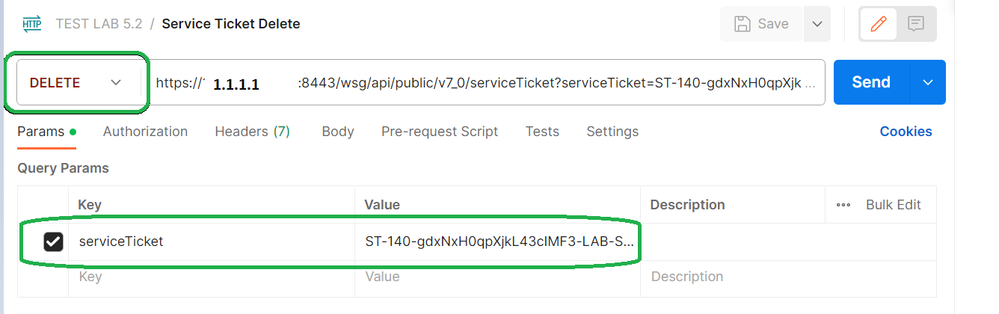

11-30-2023 04:14 AM
HI. vijaykuniyal
How do it delete?
Does it delete using logoff?
11-30-2023 09:09 AM
Hi @Jeronimo
Right LOGOFF, you can use DELETE option to delete a service Ticket.
Example:
