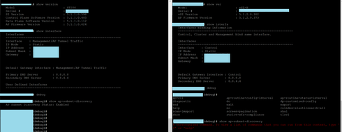

Hello Syamantak,
I tried on different vSZ we deployed recently and command is not there, might it be difference between vSZ-E and vSZ-H ?
We were told that there is no difference and we should always use High scale.
I also tried on 104 without any issue.
Image_ images_messages_5f91c499135b77e247b05a53_66764ea1ef4dc5f541bd1c7c8aa2b565_RackMultipart20200807983451ege-ce34fea4-a3dd-4dc2-9107-148e5544101f-1355278057.png1596802472
Thank you.
David
Hi David,
I have discussed this internally for vSZ-H and found that AP L2 discovery is not supported on vSZ-H, SZ-200 and SZ-300. Please use DHCP option 43 or DNS for automatic AP controller discovery.
Only vSZ-E and SZ100 supports AP L2 discovery. Same is not support on vSZ-H/SZ-200 and SZ-300 due to design and option of multi interface setup.
