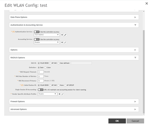

Maybe there is something in here that needs further configuring when setting up the SSID. Under "RADIUS Options".
Image_ images_messages_5f91c449135b77e247a02f15_4ec362288a6a5d6c49b60de8bd95f59c_RackMultipart20200421753301aop-f8fe447a-25bc-4f22-b377-9c1f0e4668ca-1457732284.png1587483916

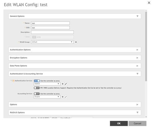

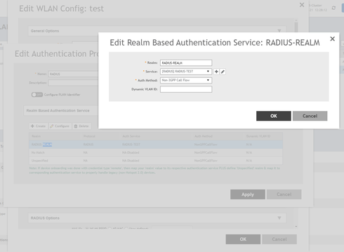

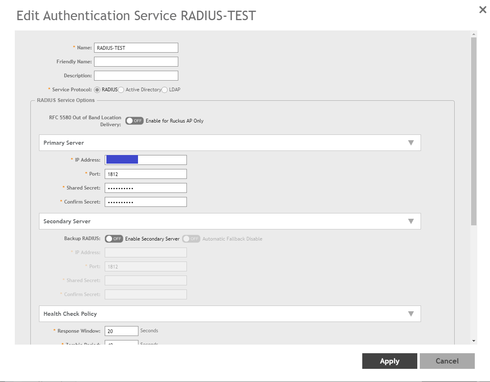

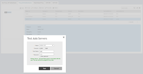

I've tried that a few times to no success. This is ultimately how i'm going to have it setup, but for testing purposes it seems faster setting up the Non-Proxy. I get the same results, can't authenticate with the SSID.
Image_ images_messages_5f91c48f135b77e247aea906_604ccd5851c3ade659f547448d9d99a7_RackMultipart20200421597249ppp-b927e921-9200-4ddf-a636-c3f4c5351925-1660184995.png1587486849
Image_ images_messages_5f91c48f135b77e247aea906_b00c5283384356bd999aed5d5f18d097_RackMultipart202004216501911ge-3c55172b-6588-4f35-9018-324adc6e025b-567865332.png1587486861
Image_ images_messages_5f91c48f135b77e247aea906_380759645091fef0da965575032d0264_RackMultipart20200421556161hgt-99640f77-483f-4fb6-bc1a-986f91caecdf-2019300060.png1587486879
Image_ images_messages_5f91c48f135b77e247aea906_36f41c24249f91f61951b2126108eae4_RackMultipart2020042145849ngdn-59140199-280f-4277-b21f-1e25550fe3aa-1235534718.png1587486891
I don't have a ZD right know to check screens and show you exactly the menus, but I think that it has to be with the WLAN no being added to the user groups. Check default user group or any custom ones and check if the WLAN you're testing is added. Maybe I'm wrong, but I think it's worth the try.
