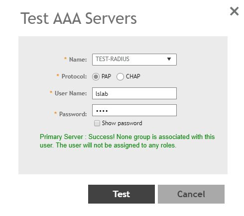

The Event Logs for NPS work, but when trying to authenticate to a SSID with a Wireless Device it doesn't even make it to the Server. How do i know Event Logs work, because if I have a successful or failed attempt directly from the AAA in the vSZ Controller it gives me a NPS Event Log.

I'm thinking it's something down those lines. By checking "Virtual" I no longer get a Failed attempt using the NAS Port Type Condition. But I still get the below picture and still cannot authenticate with Wireless devices.

04-21-2020 08:50 AM
The Virtual and Port # seem ok because it is a Virtual Controller via Hyper-V and that's the port # required to access the web portal interface. But because it is Virtual, i'm thinking there are some configuration tweeks that need to take place somewhere.
