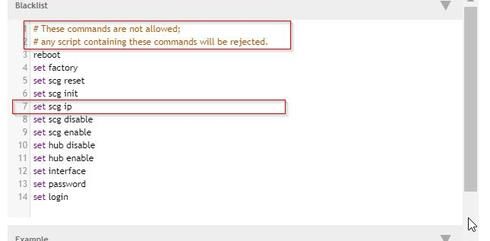

Hi Guys is there any ways to migrate the multiple ap from smartzone to diffrent smartzone? i know we can use remote ap-cli but it is for single ap only.
NOTE : the version of the controller is 5.1.2 so we cannot use AP CLI SCRIPTS ALSO

Hi Sanjay is says that set scg ip script are not allowed in the version 5.1.1
