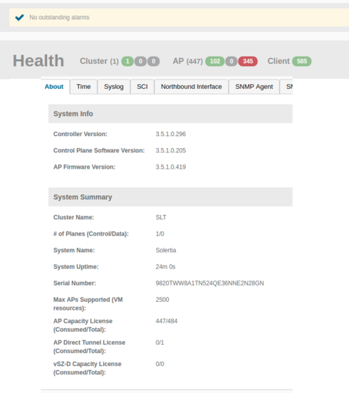

We have the VSZ-HS with about 500aps, since last Friday after a restart due to a maintenance on the machine that houses the instance the system has stopped working properly.
I do not know why strange reason only gives me access to 102 access points, I have around 500 ap-capacity licenses but only the first 102 are connected. I do not know what else to do, from liman I have deleted / added the licenses again, I have synchronized and not I know what else to do.
Also in tried to update the VSZ with some patches of the download center but it tells me that I need license for the upgrades, it seems incredible that I need a license to be able to update.

I have the free margin that you indicate, in the following comment attached screenshot of the state

Sorry for the delay in answering, I moved the instance to another hard drive with larger size in case there was a space problem but I see that it is not like that.
I attach the screenshot
