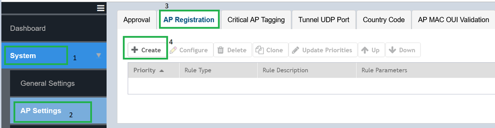

Hi @dspjones,
You can use AP registration rule  on the new vSZ which is in main environment, you can create registration rules based on IP address Range/subnet mask to point the APs to a specific zone.
Use this as a reference document for AP registration rule.
https://docs.commscope.com/bundle/sz-512-sz100-vsze-administrator-guide/page/GUID-EF10D5CB-0F7F-4C6D...
For specifically using provision tags, use this guide as a reference for script.
https://support.ruckuswireless.com/articles/000004057
