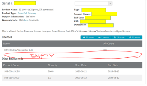

However, from about 1-2 years ago, there is a symptom that the support entitlement we purchased for our customers does not appear on LiMAN.
I have appealed to Ruckus about this several times, but I'm still experiencing the same symptoms.
Please check that the SmartZone you have purchased and the support entitlement for the device are properly registered on LiMAN.
Confirmation is as follows.
Image_ images_messages_5f91c3ff135b77e247911415_1108cb251ff28d0da72b55448d7c01c6_RackMultipart2020081421952vc3k-3d84d673-4f19-4ece-8726-bd2c3f2a6c87-936246165.png1597366097
You may not notice if the license is properly activated in LiMAN because there is no problem with SZ running even without the corresponding license.
However, if you suddenly need to upgrade in the future, you will be embarrassed because the upgrade is not possible without the support entitlement.
