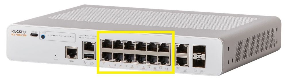

right, how do I do that when I do not see the ruckus connected to my computer? I am using ethernet connection from the 10101

Hi @katiemitz
The cable should be connected in 1 of the 12 ports available in the middle
