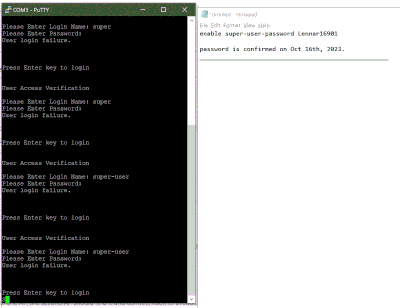

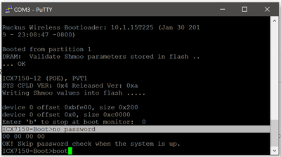

10-17-2023 09:24 AM - edited 10-17-2023 01:01 PM
I use USB-C cable to access the console.
I can enable admin privileges only by bypassing the password at the time of rebooting. Then I can access CLI and see my switchboard name. I can make changes per the instructions and then save them to mem. It seems to work.

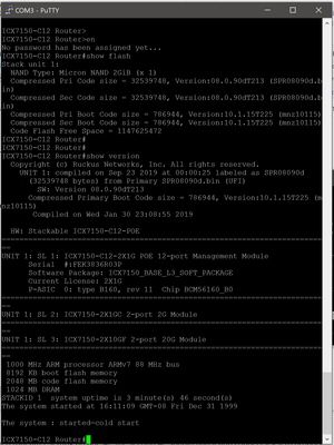

Thank you for this suggestion. While waiting for your reply, I already tried the factory reset.
It was loaded, but I don't see SPS08090d.bin when I run "show flash" command. I only see two records of SPR08090d.bin.
10-18-2023 09:50 AM
Hi @Sergy
Currently, the optimal choice would involve uploading the correct image (SPS08090d.bin). However, given that you will be carrying out this task, I would strongly recommend upgrading to the 8095g image (SPS08095g.bin) for the best outcome.
Please follow the below steps explaining the Upgrade process. The recommended stable version is 8095g (08.0.95g)
