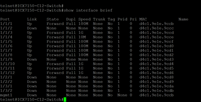

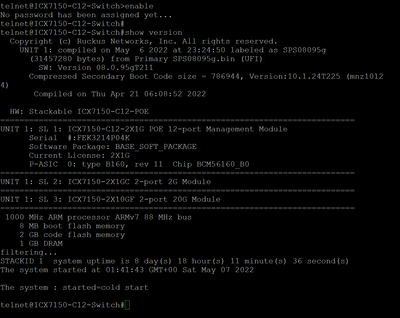

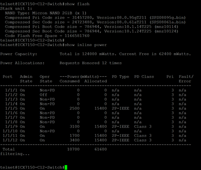

Below are the commands:
show version
show flash
show inline power
show inline power detail
show interface brief
If you encounter any issues while following the steps or retrieving the command line outputs, please feel free to let us know, we will be happy to assist you.

Hi Imran,
Here are the details:
Just a recap of my issue - My ruckus wireless stops working in a little while and needs a restart. Even for restart, I need to plug out the switch, wait for few minutes and then plug it back in. Again, it works for an hour or so and the same issue. I have three APS. the IP scanner shows only 2 APs and the switch. now. I see the AP that is not showing up has the power LED in yellow.
I had been suffering this past 2 months and this is seriously impacting my work from home job. as my phone cannot connect to wifi. I am hardwired to my laptop.

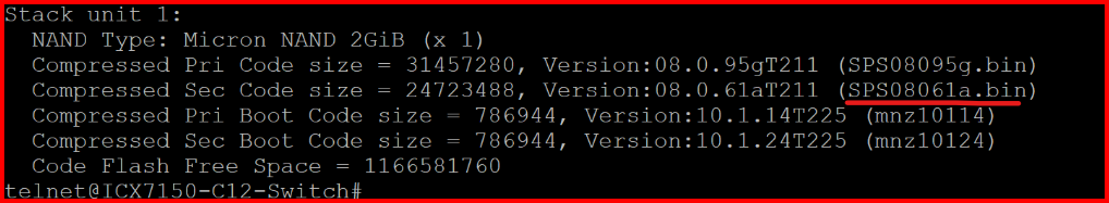

I see from the output you shared, your Switch is on an older version on the secondary partition as highlighted in the below screenshot.
Please execute the mentioned commands to copy new version from primary partition to secondary partition and check if that works:
copy flash flash secondary
Example:
VIDEO LINK AS REFERENCE: https://www.youtube.com/watch?v=Eem1IBgYaWc
ICX7150-24P Router#copy flash flash secondary (hit enter to accept the command and wait: until the flash finished)
ICX7150-24P Router#boot system flash secondary yes (hit enter to accept the command: the switch will reboot)
Please let me know how it goes.
