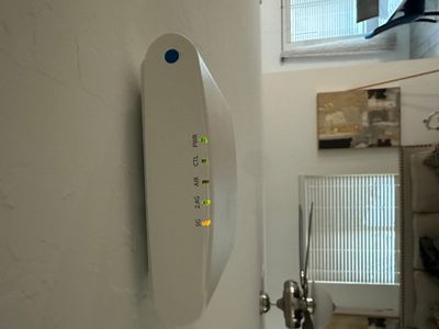

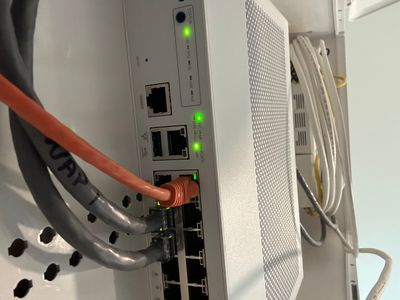

My wireless access points are not working after a power outage. I have lights on the access points in my house but not getting a signal from them. Also on my unleashed dashboard it says my switch is disconnected.

We appreciate the information provided regarding the issues with your RUCKUS setup following a power outage.
Upon reviewing the images you shared and assessing the status of the RUCKUS ICX-7150-C12P Switch and Access Points, it appears that they are currently in a normal operational state. However, it seems that the switch has booted up on the Routing code (SPR) due to the power outage, resulting in the observed issue.

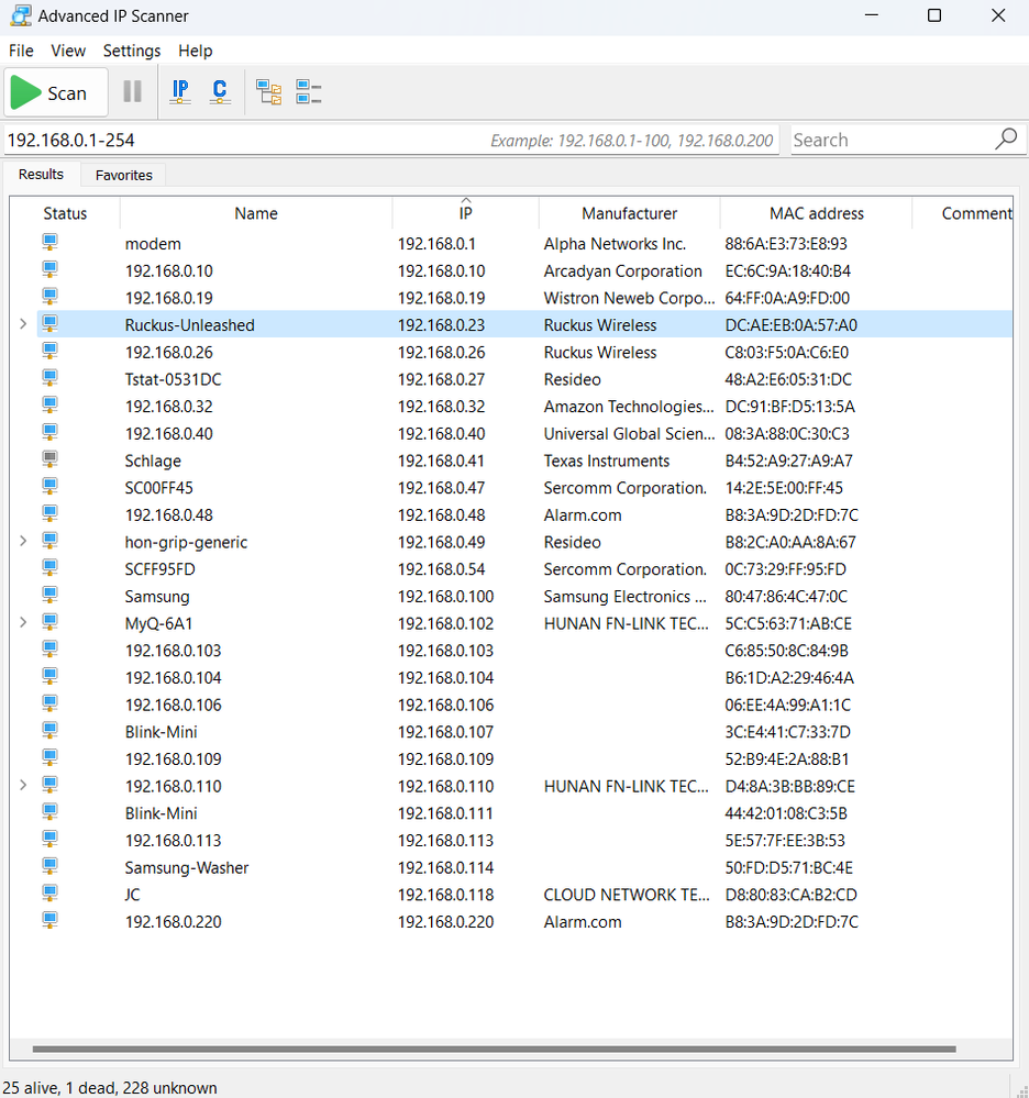

06-11-2024 05:28 PM
Here is a list of every IP address that showed up on the IP scan. I tried all of them and none of them connected me to the switch.
