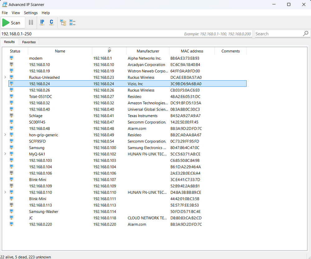

I kindly request that you disconnect the Ethernet cable of the Internet Service Provider's (ISPs) Router from the Switch port and connect it to any other available port numbered 1 through 12, as indicated in the screenshot provided. Subsequently, proceed to reboot both your ISP Router and RUCKUS ICX-7150-C12P Switch by unplugging them from the power supply and plugging them back in. Once both devices have completed the reboot process, please conduct an IP scan to verify if an IP Address has been successfully assigned to the Switch.
I would appreciate it if you could verify and confirm if this works.
06-12-2024 05:43 PM
I tried it in 4 different ports restarting both my ISP and switch each time. Still no switch IP address.
