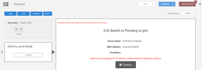

I for sure have Ruckus Switch (ICX 7150-12CP)
When I do the scanner, the Ruckus Unleashed IP addresses that shows up don't match the MAC address of my Ruckus Switch (ICX 7150-12CP).

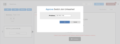

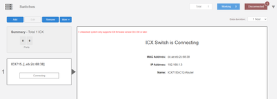

Ok. I reset the house router so that I could access what it was connected to and found the correct IP Address for my "ICX 7150-12P Switch". When I put that IP address in the admin dashboard url area, I hit ok and it says "pending" and won't connect. It's been like that for awhile now.
When I hover over the "ok" button, a red circle with a line through it shows up like below:
