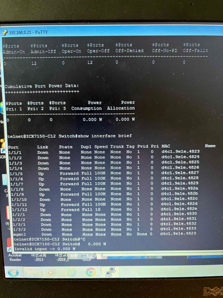

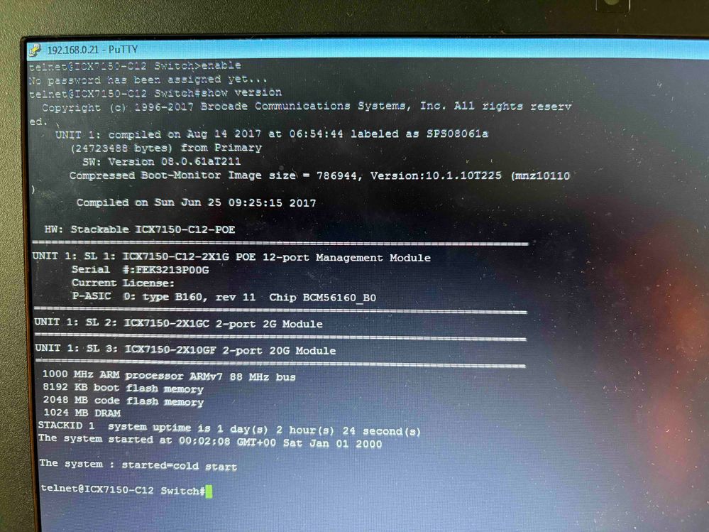

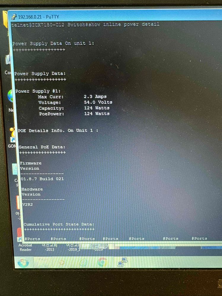

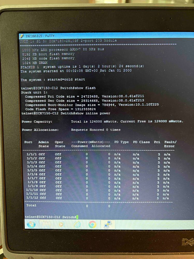

Here are the outputs of the command
Hello @junjang ,
From the screenshots you shared, I see that the PoE is disabled on your Ruckus ICX-7150 Switch.
To fix this issue and enable the PoE on the Switch, please perform the commands on the CLI:
Switch>enable
Switch#configure terminal
Switch(config-mif-1/1/1-1/1/12)#inline power
Once you perform the above commands, all ports should be On, and Access points should get the power.
Once the RUCKUS ICX-7150-C12P switch ports come online, it should fix the issue.
Thanks .  This resolved the issue.
