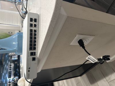

Dear RUCKUS Support Team,
I am writing to request immediate assistance with my RUCKUS ICX-7150-C12P switch. The device was previously operating without any issues, and there were no power outages or surges in the home prior to the failure.
Earlier today, I received a notification that my smart home system had been disconnected. Since then, I’ve attempted several self-troubleshooting steps—including disconnecting and reconnecting the switch, changing the power source, and performing a manual reset following your online guidance. Unfortunately, none of these steps have resolved the issue.
Attached is a photo showing the device connected to a verified working outlet. Upon plugging it in, the lights on the switch flash for less than a second and immediately go out, with no further activity or indication that the device is receiving power.
This switch supports all of my home’s critical systems, including security and smart automation, so restoring functionality is urgent. I kindly request that a qualified technician contact me as soon as possible to assist with further diagnosis and resolution.
Thank you for your prompt attention.
